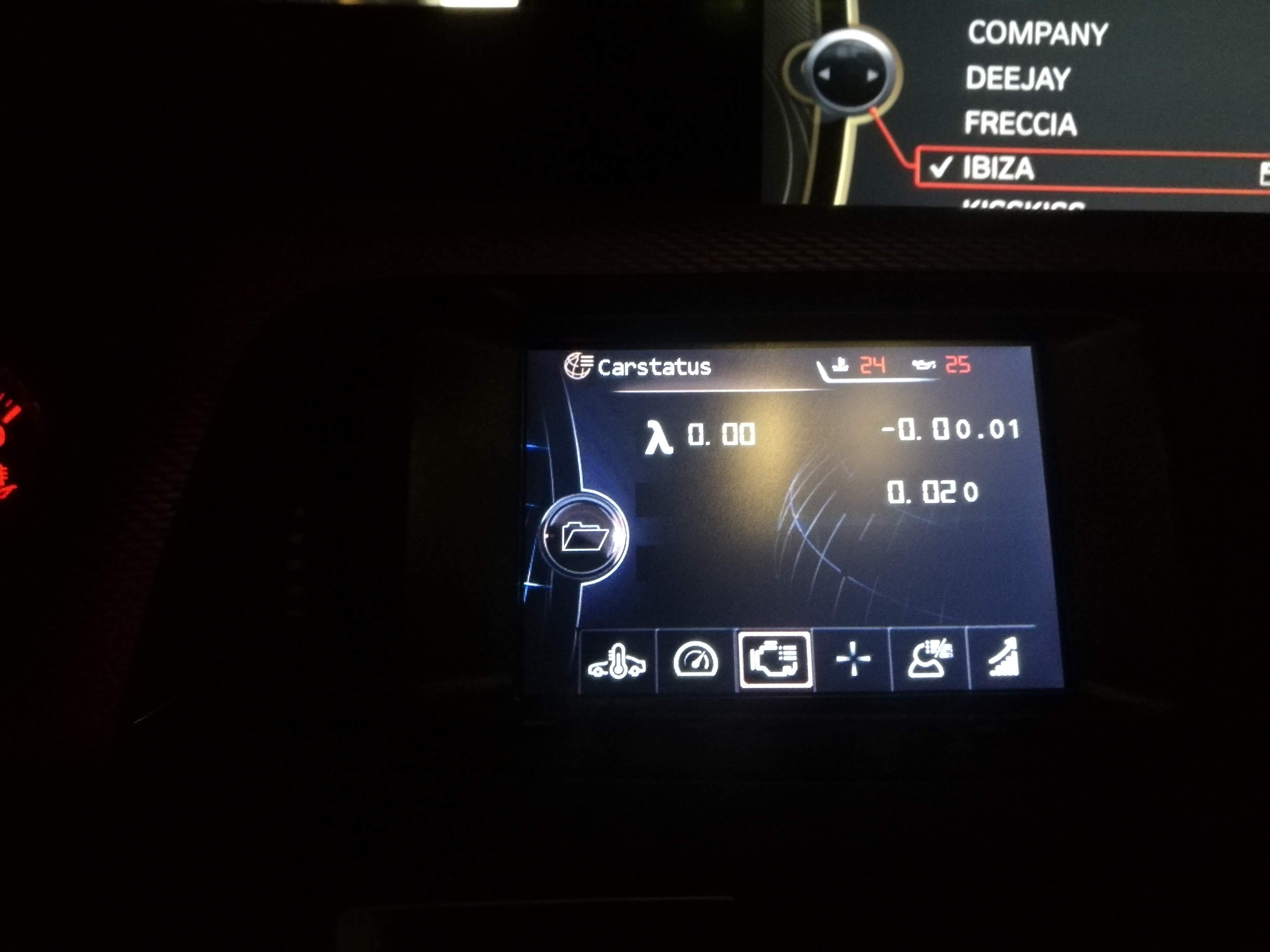

I have installed the data display in a F30 328i with N20 motor and manual transmission. I select the english language since italian has some bug and is not very good translate from the original language.

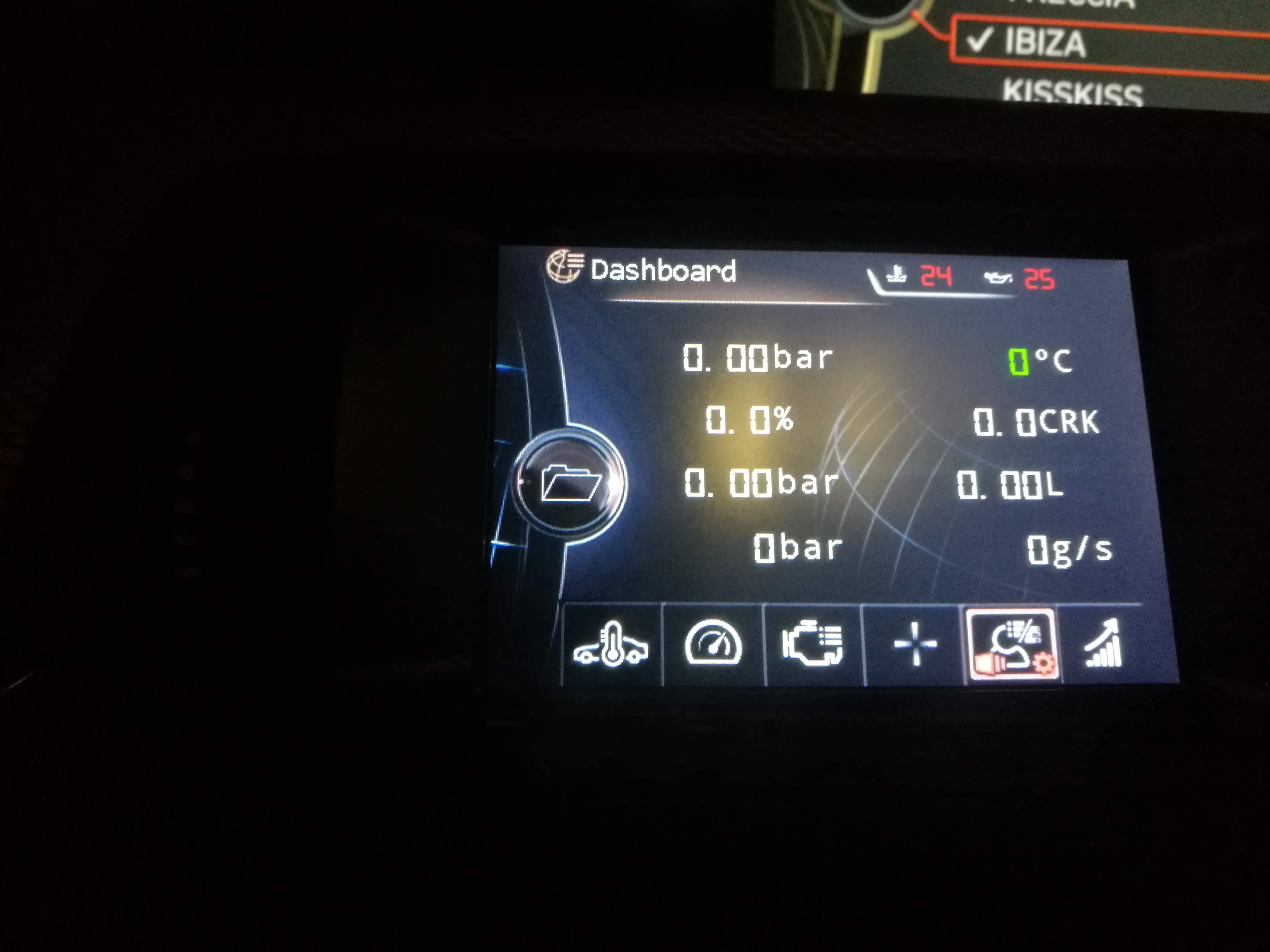

As showed in the picture, in the car status screen, only the lambda value is displayed and some numbers with no sense. Is it a bug for my configuration? In the custom dashboard I'm able to read all the other motor data.
Motor data dashboard
Custom dashboard
Custom dashboard

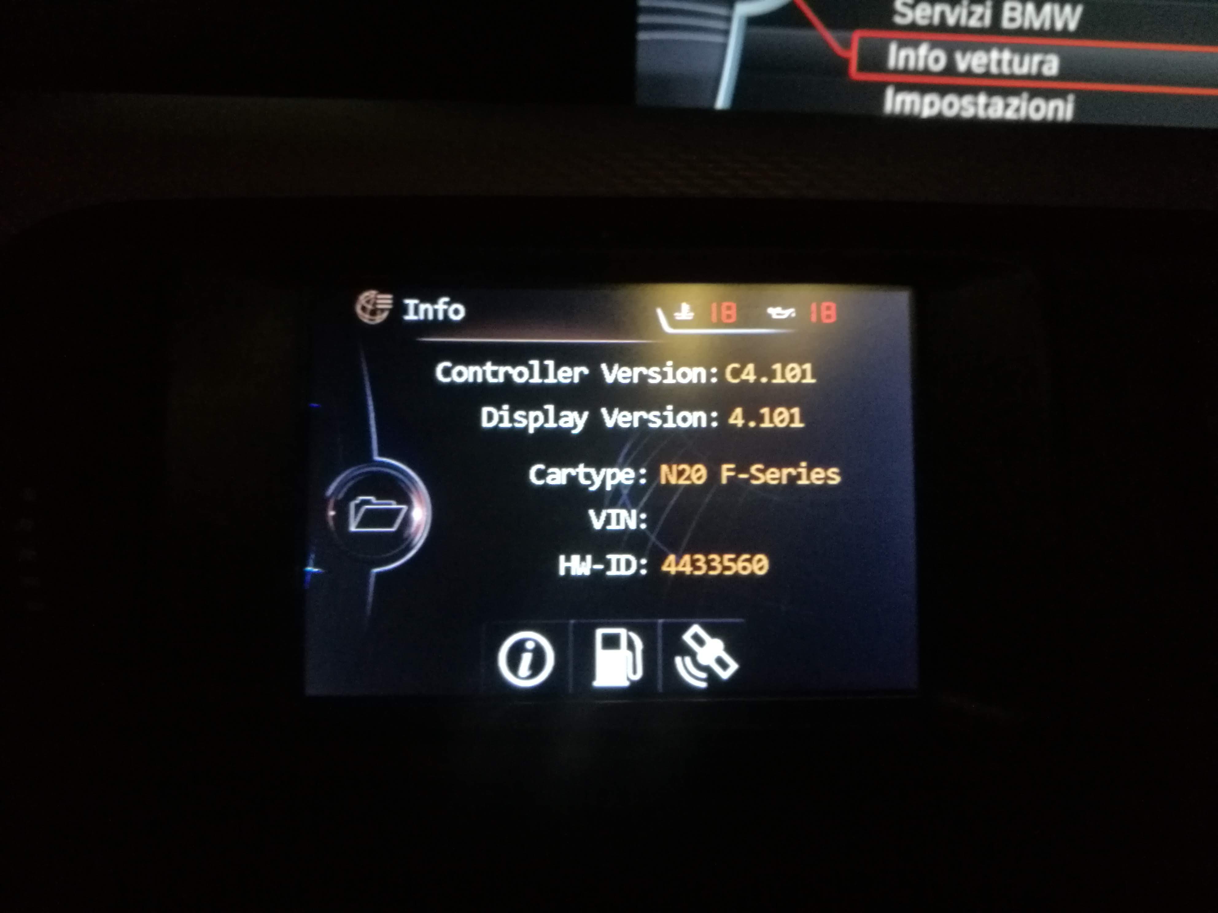

Can you please send a picture of the Info Page?
From Mainmenu the Info-Symbol button.
I will check whats going wrong here with the N20 Enginge.

Small Update.
I found a problem in N20, you are absolutly right.
Two ways, i can send you an updated Controller_Version.hex file and you can test, or you set the display back to factory settings and choose N13 engine instead of N20 (no difference for the DataDisplay).
This should work fine, but please send me feedback.
Thanks.

Dear Alex, thanks for the support. I have the picture of the info screen. This evening I'll try to use N13 motor in the settings and I'll give you a feedback as soon as possible. Then if it is not enough I can also test your hex modded file.
Information screen
Information screen

Dear Alex, I confirm that using the N13 setting the values are correctly shown! I think you will insert the correction in the next update of the display firmware. I'll waiting for them. :)
Re: Problem in motor data screen
Thanks a lot.
I allready fixed it (hopefully) and the change will be in the next update.
